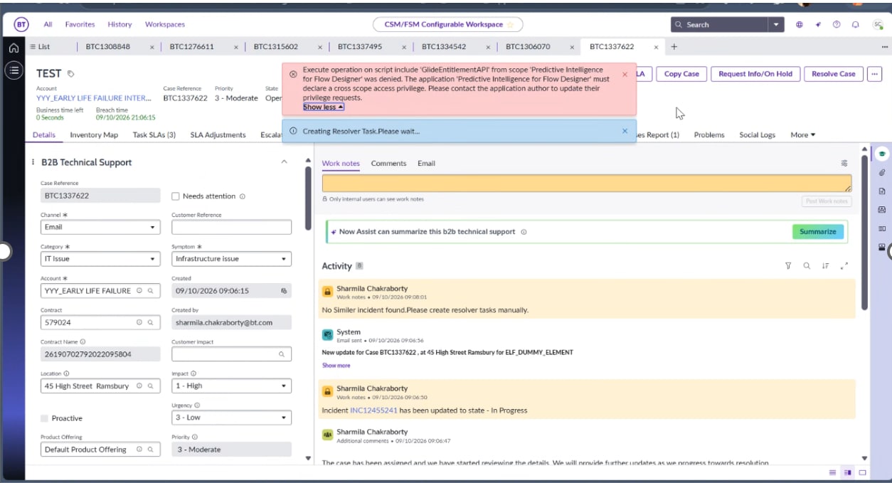

I'm facing an issue in Production with a Resolver Task Creation flow that uses Predictive Intelligence for Flow Designer.
The functionality works successfully in Dev, Test, and Beta, but fails only in Production.
When the Resolver Task button is clicked, the flow errors with:
The actual error is:
"Execute operation on script include 'GlideEntitlementAPI' from scope 'Predictive Intelligence for Flow Designer' for Flow Designer was denied. The application 'Predictive Intelligence for Flow Designer' must declare a cross scope access privilege."

Hi @swapnali ombale
Based on the error message, this appears to be a cross-scope access privilege error.
Could you please verify whether you are in the correct scope in the Production environment?
If the scope is correct, you may need to configure the Restricted Caller Access privilege to resolve the issue.
Restricted caller access privilege settings
KB0690133 How to grant cross-scope access to an application or module
How to fix the red popup "... must declare a cross scope access privilege" errors

Hi @Tanushree Maiti  thank you for your response but the thing is I am in correct scope n all  of If i  need to create across scope record to fix this I need proper justification because without this workaround in lower environment it is working in lower environment that they ask why it is not working in production it should work in production as well. I don't have proper justification.
Hi @swapnali ombale
This is quite unusual.
I would suggest double-checking whether any Application Cross-Scope Access records have been created in the non-production environment, even though the functionality is working fine there.
If the issue persists, you may consider raising a case with ServiceNow Support for further assistance to check discrepancies in production.
