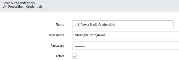

Credentials
Though we're not using Basic Auth, NTLM authentication is similar in that it wants a username and password.  So, we started by creating a Basic Auth Credential (basic_auth_credentials) that provide the username and password we'll need to use to invoke our target API.  We don't want to create an alias, because we don't want to use these credentials to log into a target host - we're just trying to safely and securely store the credentials we're going to use later.
