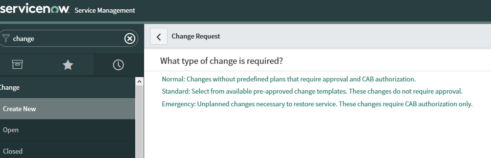

Has anyone added additional condition on change interceptor. I have requirement where specific role should not able to create change request from interceptor, even if user has itil role.
I have tried to add script in interceptor to check if user has specific role or not but no luck. Also, I have client script and client script worked and display error but form stays and if user close error message, she/he can submit request.

I have tried gs.setRedirect(url) option but its not working.
