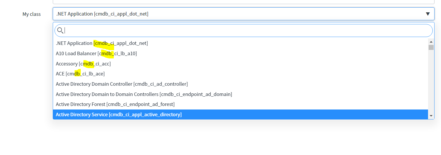

I have created a custom field My Class (field type - table name). Will I be able to restrict the drop-down selection for this field such that only those tables can be selected for which name starts with cmdb_ci?
Any leads will be appreciated!!

What you can do is you can add a attribute called 'base_table' and give default value as cmdb_ci. This will give you cmdb_ci tables

‎02-06-2017 01:52 AM
Awesome!!! Thanks Harish
