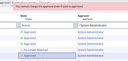

Juhi Poddar
Hello @Avinash72
  • Logic implemented is when the state is not requested then approver will not be able to change the state.
  • This will prevent approver to change the state once it is rejected/approved/no longer required/cancelled.
Create a Before Update business rules:
Screenshot1: BR configuration setup
Screenshot2: Advanced tab in BR
Business Rule Condition:
current.state != previous.state
BR Script:
    // Add your code here
    var approver = gs.getUserID();
    // Check if the current user is an approver
    if (current.approver == approver) {
        // Check if the current state is not 'Requested'
        if (previous.state != 'requested') {
            gs.addErrorMessage('You cannot change the approval state if state is ' + previous.state);
            current.setAbortAction(true); // Abort the update
})(current, previous);
Result:
Hope this helps!
"If you found my answer helpful, please like and mark it as an "accepted solution". It helps others find the solution more easily and supports the community!"
Thank You
Juhi Poddar
