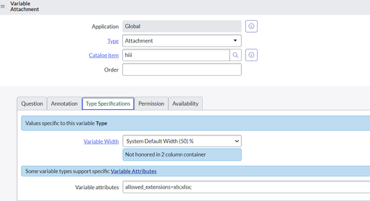

Hi @bhuvana srini ,
Simplest way to achieve this is using Variable Attributes.
Add allowed_extensions=xls;xlsx; in variable attributes of your attachment field.

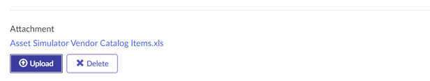

If Excel
If not excel
