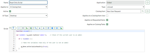

I have implimented a Catalog Client Script that will make all the variables on a RITM and Catalog Tasks read-only once it has been submitted by the user.
The script I used is as follows:
This works perfectly fine apart from when the Fulfilment groups go into the RITM and then try to access a Task or leave the page.  When they do this they get a pop-up message saying "Do you want to leave without saving?" when they haven't changed anything.

I have managed to get this working by adding g_form.fieldChanged = false; into my Client Script as per below example:

Thanks Tony,
I gave this a go and created a Client Script against the sc_req_item table (as below) but got the same result unfortunately.  I have sifted through the documentation and can't find anything that mentions this sort of thing happening.
