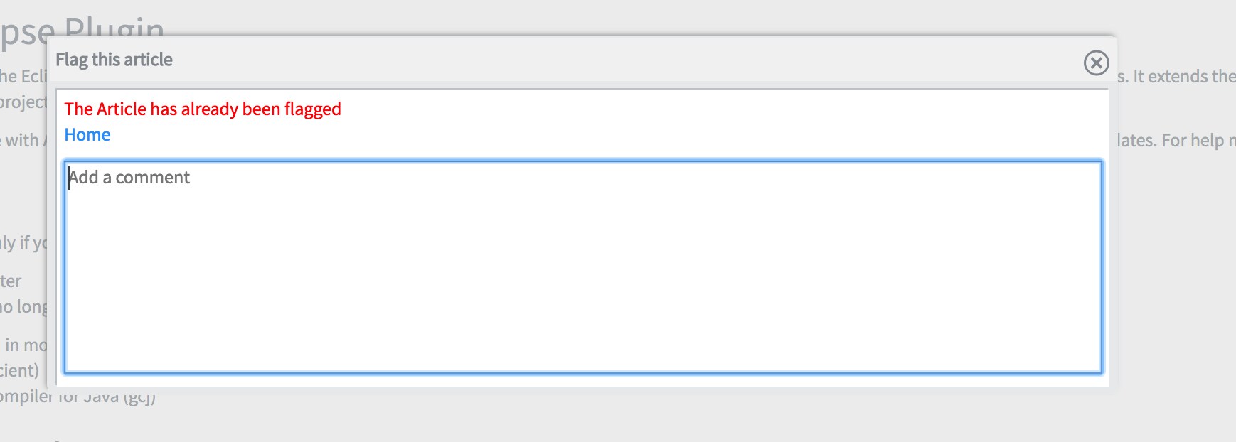

I am trying to display a message like below when a flag article button is clicked on a kb article which has already been flagged. So, I am using the above the script in kb_view_suggest ui page trying to pull the sys id from kb_view page url. Am I approaching the wrong method? Thank you.
