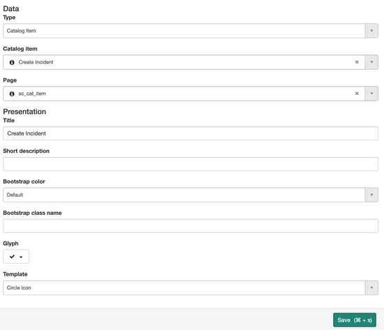

Result expected:  when you click on your Icon Link it will open your record producer.

abebriones9
 It worked. Thanks!
