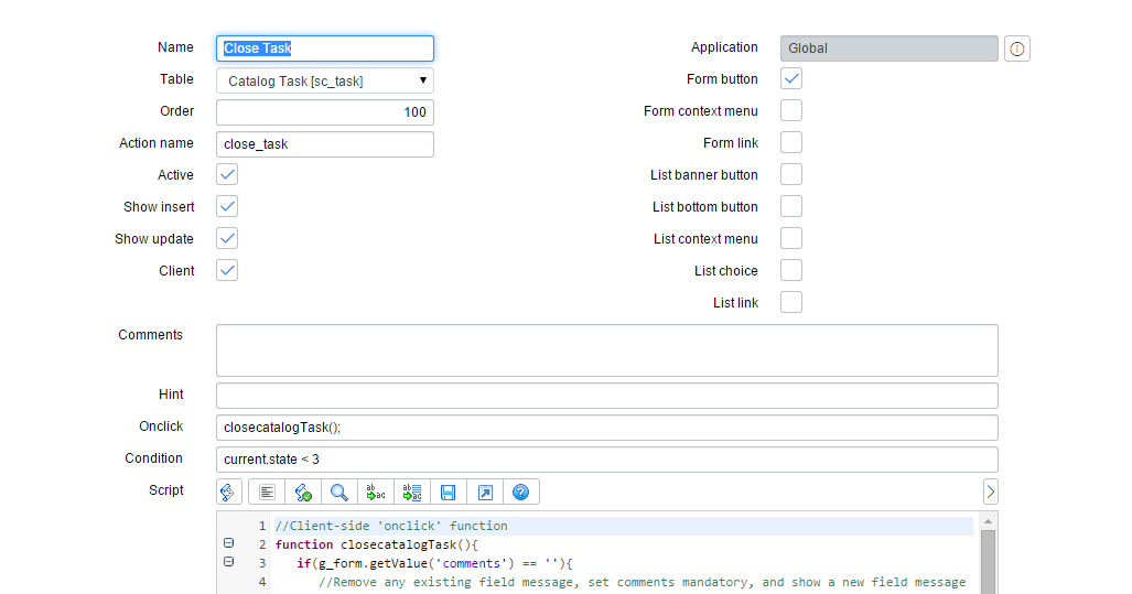

neetusingh
Giga Guru
As per your requirement, I believe that you may want to make the comments field as of mandatory whenever an ui action (Close Task) being clicked upon. So you may modify the code a bit in to your existing ui button to let both of the server side code (that would make your tasks as closed completed after validating the client side checks i.e making the additional field as of mandatory) and client side code (that would mark the comments field as mandatory if the additional field is empty) execute.
You may try the below solution -
script code -
//Client-side 'onclick' function
function closecatalogTask(){
    if(g_form.getValue('comments') == ''){
          //Remove any existing field message, set comments mandatory, and show a new field message
          g_form.hideFieldMsg('comments');
          g_form.setMandatory('comments', true);
          g_form.showFieldMsg('comments','Comments are mandatory when closing a task.','error');
          return false;   //Abort submission
    //Call the UI Action and skip the 'onclick' function
    gsftSubmit(null, g_form.getFormElement(), 'close_task'); //MUST call the 'Action name' set in this UI Action
//Code that runs without 'onclick'
//Ensure call to server-side function with no browser errors
if(typeof window == 'undefined')
    closeTask();
function closeTask(){
    //Set the 'State' to 'Active', update and reload the record
    current.state = 3;
    current.update();
    gs.addInfoMessage('Task ' + current.number + ' has been closed.');
