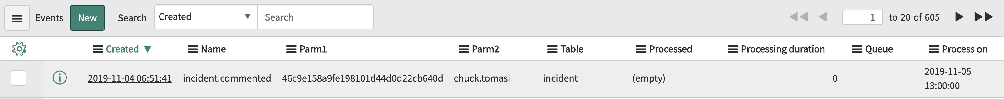

If we schedule an event like this , where can we see the list of pipe lined ( scheduled to be executed in future ) events .
I cant find it in event queue . Event queue is only showing events which have already been executed
The event is definitely in the event queue. Check to ensure you don't have a filter on the list (you are viewing all records.)
I just sent one to the event queue using gs.eventQueueScheduled() and it's there. There is a field called "Process on" that holds the date/time from the fifth argument. When I added it to the list, I can see the time.
