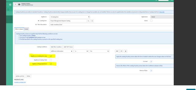

Hi @Gemma4
In that case you can create & run separate UI policy which will run specifically on option selected.
highlighted in below screenshot.
1.Create first UI policy which will apply only on catalog form
Applies on Catalog form : will apply only on portal/native UI before submission
2.Create second Ui policy which will apply only on RITM and change the logic
Applies on requested item : will apply only on RITM after submission
ServiceNow Developer
- Socrates
