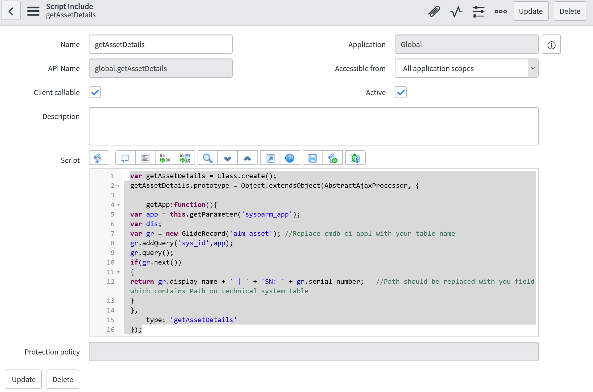

I have created the following Script Include:

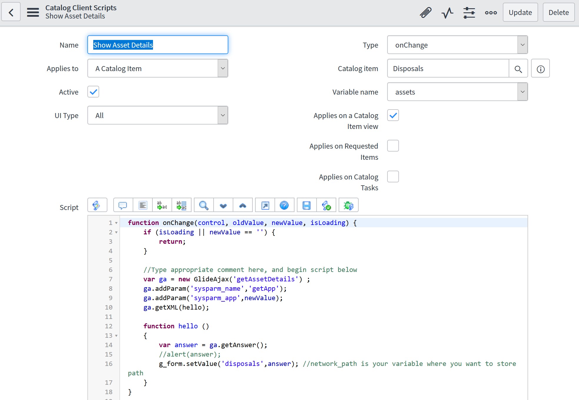

On the Cat Item I have created the following Catalog Client Script
 Basically what this doing when you select an Asset on the cat item it is pulling back the display name and serial number to the Disposals field:
Is there a way I can edit my scripts so that if multiple assets are selected in the List Collector the display name and serial number will be displayed for each on a new line?

Thank you for getting back to me on this. I am little confused where your above script lines needs to be amended. This is the full script include, could you kindly update for me so I can see where the changes need to be applied:
var getAssetDetails = Class.create();
getAssetDetails.prototype = Object.extendsObject(AbstractAjaxProcessor, {
getApp:function(){
var app = this.getParameter('sysparm_app');
var dis;
var gr = new GlideRecord('alm_asset'); //Replace cmdb_ci_appl with your table name
gr.addQuery('sys_id',app);
gr.query();
if(gr.next())
return gr.display_name + ' | ' + 'SN: ' + gr.serial_number; //Path should be replaced with you field which contains Path on technical system table
type: 'getAssetDetails'
Try as Below,
getApp:function(){
var arr = [];
var app = this.getParameter('sysparm_app').split(',');
var dis;
gr.addQuery('sys_id','IN',app);
gr.query();
while(gr.next())
arr.push(gr.display_name + ' | ' + 'SN: ' + gr.serial_number); //Path should be replaced with you field which contains Path on technical system table
return JSON.stringify(arr);
