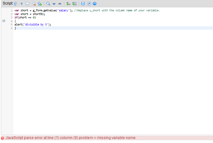

Hi, I have replaced 'u_short' with the variables name 'salary' but I am getting an error. Please see below:
Full screenshot
hi,
just see, variable which are using here is already declared in record producer or not!
thanks
