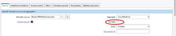

I'm working with a customer requirement. They need a performance analytics indicator in order to count open demands for everyday. It should build a trend chart where any point is the count of the new demands in every day. For example, if we created 2 new demands on wednesday, 3 yesterday and 4 on today, the PA indicator should show 2-3-4 in the trend.
I have tried to build it with the pre-configuration filters but I haven't had good results because everything I do will always add up the data (2-5-9). It seems it's not possible to make it with filter conditions so...I'm thinking to get it with an scripted indicator but I don't know how to build the basic jscript structure.

12-01-2023 02:49 PM
Hi @Leonel Sandroni ,
You requirement is quite easy without any automated scripted indicator. If you just create a daily indicator source based on the demand table, you will be able to capture 2-3-4 instead of 2-5-9. Remember the condition in the indicator source should contain "created on today" - otherwise it will not work.
best regards
Anders
