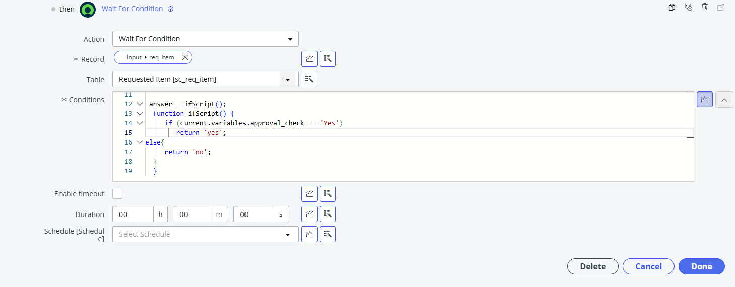

I am trying to script the Wait For Condition and have it check for the value of a catalog variable.
The catalog variable is "approval_check", and I want the Wait For Condition script to wait until "approval_check" == "Yes".
approval_check is just a string with a default value of "No".

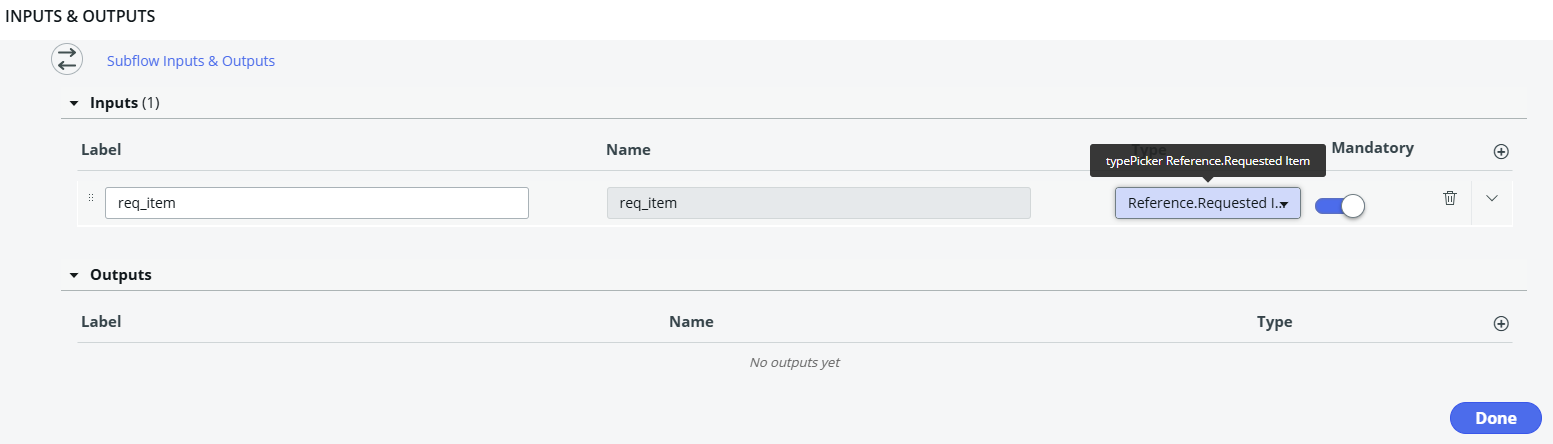

I attached photos of my Wait for condition script, and the error I am getting which is "Error: Cannot read property "variables" from null,Detail: Cannot read property "variables" from null".
Here's the script.
answer = ifScript();
function ifScript() {
if (current.variables.approval_check == 'Yes')
return 'yes';
else{
return 'no';
Thanks.

The error you're seeing — "Cannot read property 'variables' from null" — usually indicates that the current object is not correctly referencing the record with the variables property. This is a common issue in Wait For

Current isn't accessible in Flow Designer, that is the older scripting convention in legacy Workflows. You need to access the record via the fd_data object as mentioned in the comments that appear in the script editor initially.
Additionally, because the variable update is occuring on a related table (sc_item_option) I don't think this would work.
You could set the wait for condition on sc_item_option. But a better option might be to generate a task where a user is required to modify this variable, and then close it. On closure of that task, you can then proceed.
