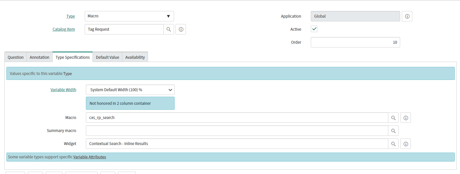

Okay, I followed the instructions and created my Record Producer Configuration but I can't figure out how to set up the filter config or search action config
Also added the Macro but the contextual search isn't appearing on my form - should be right in the space under TAG request
Here is how I set up the field
