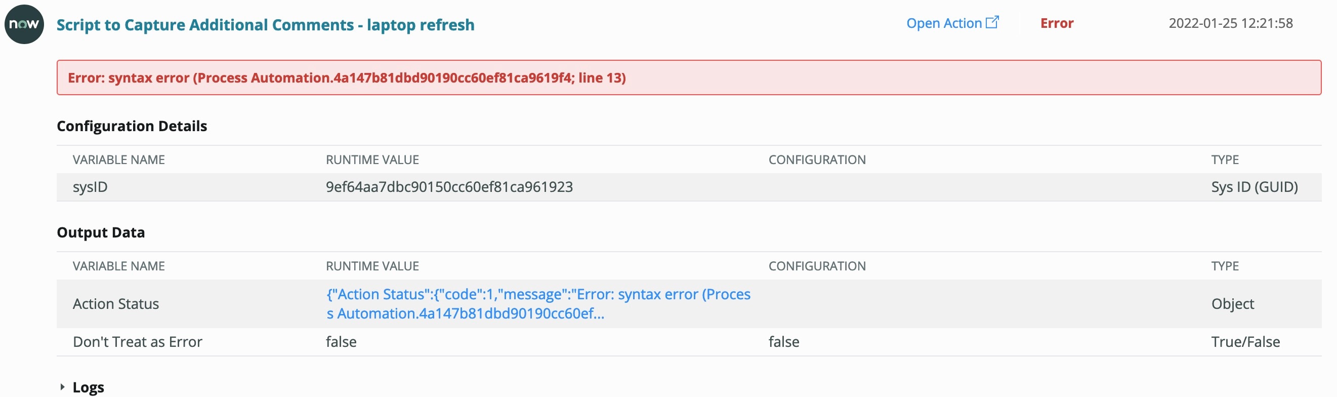

Here is the code i'm trying to get working.  the sysID is the inputs Label and name is sysid.
outputs is Label: TF name: tf  I get an error stating something is wrong with line 13 (last line of the code below).

You are missing a } to close the function
