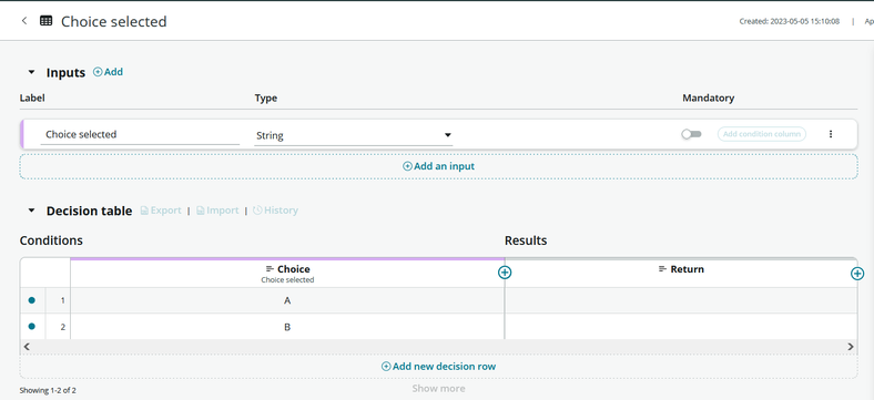

Hi, I'm new and I was hoping someone could explain to me if I'm doing something wrong.
I am exploring Decision Builder and wanted to use the value selected on the catalog item's color select box variable for the decision result.
However, when I try to use it in the condition column the box is greyed out. Are select box variable types unsupported to use in the decision table? Or is there a way to get the values in the select box?
Thank you.
Karan Chhabra6
Hi @enired ,
You can set the input & condition type as string in the decision table, and pass the value of the selectbox while you call the decision table.
Script for calling the decision table:
var dt = new sn_dt.DecisionTableAPI();
var inputs = current.variables.<select box variable name>;
var response = dt.getDecision('<sys_id of the decision table>', inputs);
var resp = response.<result column name>;
