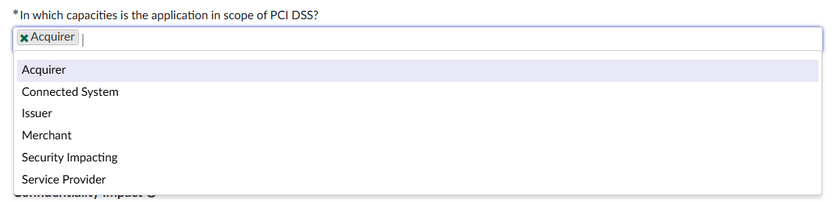

I've got a form that uses a list collector on the below field:
When I go onto my catalogue item, I'm not expecting the option of 'Acquirer' to appear. However, when I go into my catalogue item to the related question, the Acquirer option is re-appearing in the dropdown menu:

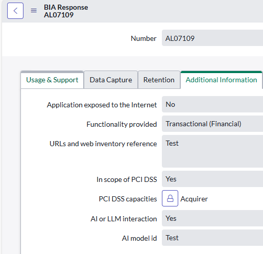

obj.pci_dss_capacities = bia_rec.getDisplayValue('u_pci_dss_capacities');

Hi @Ankur Bawiskar In the screenshot example, Acquirer in the list shouldn't appear again if it's already been selected.
It's a list collector and I'm applying the following reference qualifier:
03-03-2025 05:20 AM

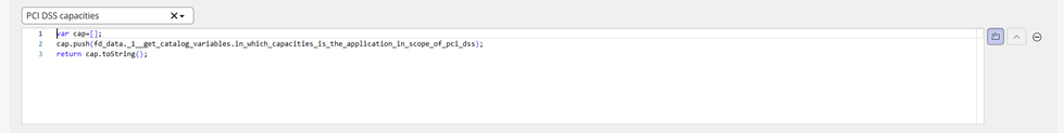

In flow designer, I'm using the following to get the values of the selected choices since List Collector is not valid in flow designer:
Could this be causing the issue?
If I try and select the variable manually, it's not allowed:
