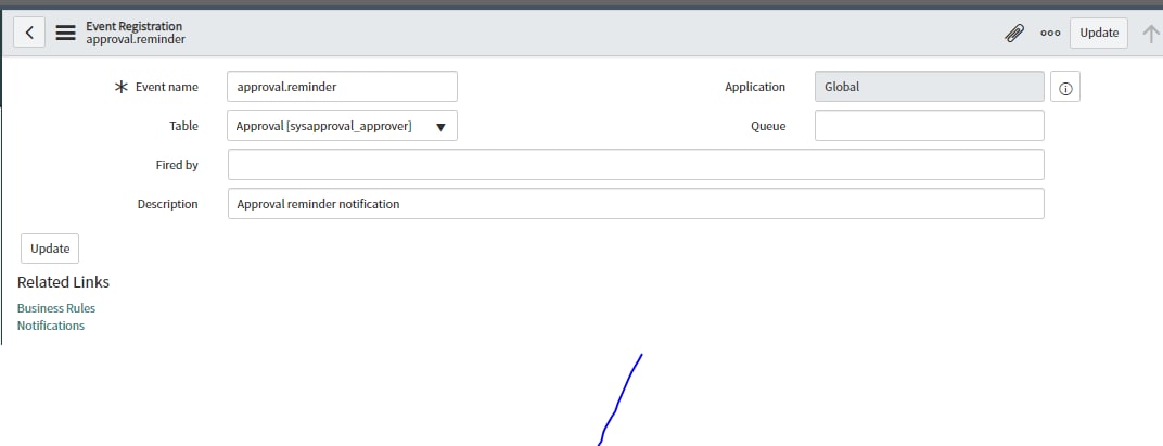

I have to send notification to all approvers for the request which is pending in their queue for approval.
I have created a scheduled job where i am calling an event. This event is then used in notification. But no notification is triggered.
Please suggest where is the error.Below are the screenshots:
2) New event created
3) Event used in notification

10-26-2019 08:05 PM
is the event fired at all??
Did you check the event log??

Hi Geeta,
Can you try to update script as below?
gs.userName() is not a valid function; use gs.getUserName() instead and test
gs.eventQueue('approval.reminder', gr, gs.getUserID(), gs.getUserName());
