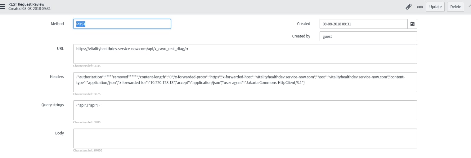

However, when we submit it (in this case I'm actually submitting this to a rest reflector we found on Share so we can see the actual body content,) and it's coming through blank.
I'm at a loss to explain why nothing's in the body in spite of the variables we've inserted?
