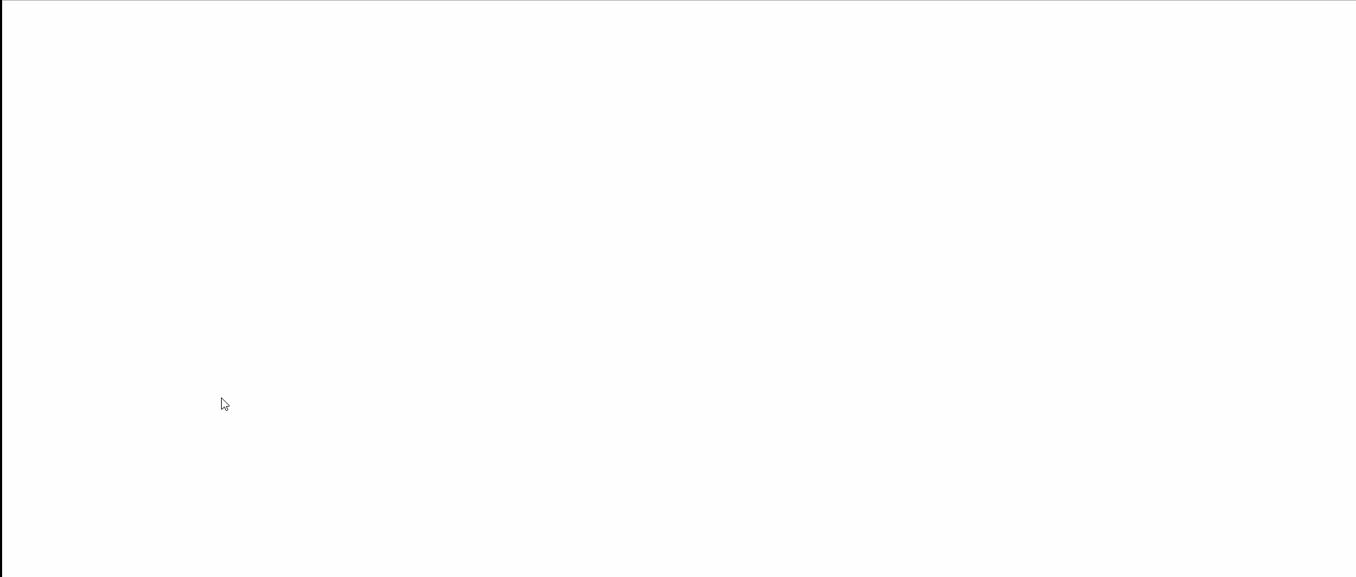

Quick Demo
hvrdhn88
Giga Patron
try now.
<p><a href="https://google.com" target="_blank" rel="noopener noreferrer nofollow">Google</a></p>
it working, i tested it.
hvrdhn88
Giga Patron
Quick Demo
I was trying to add the 'target=_blank' in the Item Details tab not utilizing the source code button and it wasn't working. This did the trick, Thanks!
