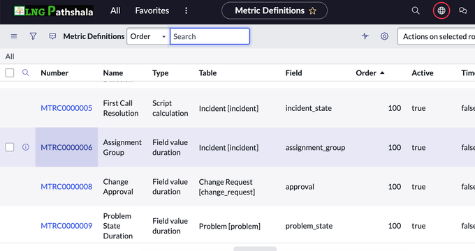

Hi @b__KieronJ
To get the old and new assignment groups, you can create a metric definition on the assignment group. Then, create a DB view of the metric and indicator table, and build the report based on that. You can refer to the OOTB (Out of the Box) metric and use it in your case.

I think this could be a complicated case because, to match this, you would need to run a query where you check if the first assignment equals resolve by.assignment group. I understand your intention is to see if SD has assigned the ticket to the right group at the first place, but this is not as straightforward as it seems using metrics. It's not an easy task, and I'm not a developer, but here’s what I think could work in a report:
- Create a database view combining the metrics and incident tables.
- In that view, find out the first assignment group or first assignee in the metrics table for each incident.
- Then, match that with the assignment group in the incident record.
This approach could give you the desired result, but it might require some careful handling of the data and logic to ensure accuracy.
