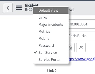

For some having issues with url fields not appearing in the Service Portal, the problem may be that the field is added to the Self Service view and not the Service Portal view. Service Portal form page uses the Service Portal view by default. Thus either add the url fields to the Service Portal view or tack on "&view=sp" at the end of the url when navigating to the form page in Service Portal.
Now for the functionality I thought I would try not to clone the form widget (widget-form) and come up with a simple widget leveraging the $sp.getForm api, using our knowledge about creating views and using url parameters.
First thing I did was create a new view for the incident form. In this demo I created the view "Links" and just added the url fields to this view.

Hi Chris,
I have set up the view for the links like you have in the CMS, but when I load the page they are there, once loaded they vanish, leaving me with the form below. So when I go to set up the widget on the portal page, obviously the widget is empty. I have not seen this behavior before, so I am a little confused.
I can't think of what I have 'set' that will make the fields vanish, they are there, but for some unknown reason to me, they stop appearing.
Suggestions?
