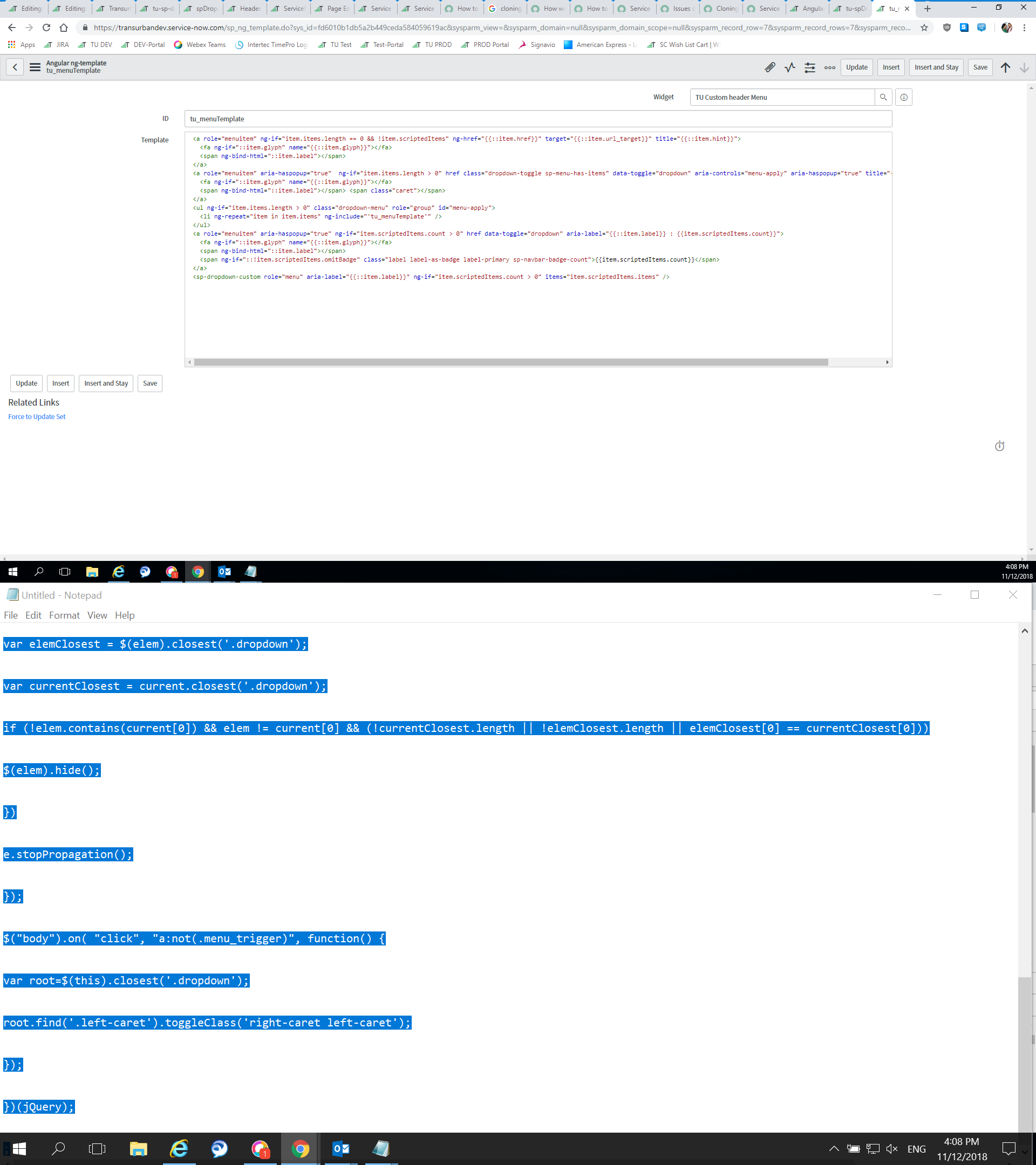

‎12-10-2018 09:16 PM
Hi Patrick,
I followed all 4 steps but somehow no menu is appearing on nav bar.Not sure what i have done wrong.
1. Created clone of Header menu widget and customized changes.
2. Added widget to Header Menu.
3. Created clone of 3 Angular ng-templates .
4. Created customized Angular Provider (named as spDropdownCustom) and updated same in 2 of Angular ng-templates as sp-dropdown-custom
Sheetal
‎02-21-2018 12:32 PM
Thanks very much for the details here! This worked for me by following the 4 steps above in detail. With step 4 the name of my custom template ended with two capital letters e.g. spDropdownAA so I had to put in two dashes at the end sp-dropdown-a-a
