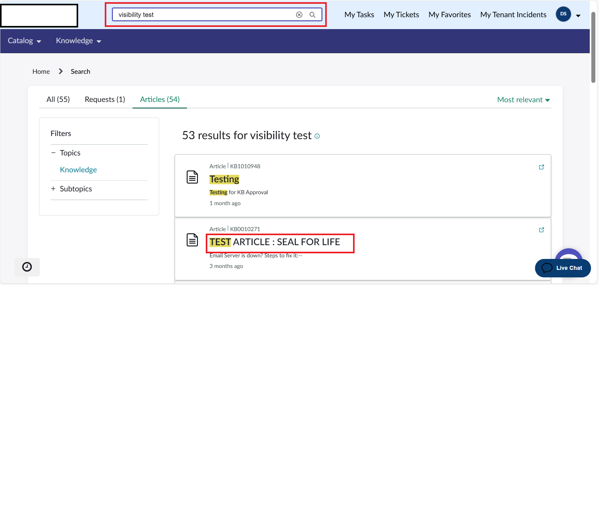

Service Portal Search results not showing up articles of a particular Knowledge Base
An article published in a knowledge base does not appear in the search results when searched from service portal's search bar , while the same article when published in another Knowledge base appears in the search results when searched for.
I have checked OOTB "Facet generation script" it looks fine .

Thank you for response, above solution did not work, When i am searching an article linked to a custom KB it does not appear in the search results of the portal search, unlike other articles appear in search results which are linked to OOTB KBs .
I have attached screenshot for your reference .
I tried above solution it didn't work. When i am searching for the article which is linked to a custom knowledge base on service portal, it does not appear in the search results,  but articles which are linked to OOTB knowledge bases appear upon searching.
I have attached screenshots for your reference .
