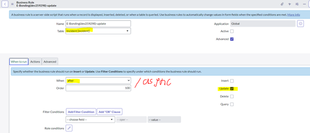

Hi @Ravi Gaurav, first thank you for the response, been learning a lot a lot from your videos and second, I have successfully created the above requirement which I have been trying on E-Bonding and Integration, I was doing one thing wrong and now I am all good.
Also, I need to know one more things, how can I make incident records be updated on the target instance when I update it on the source instance?
Your response will be appreciated.

Hi @MohdF
I'm glad to hear that you've been learning a lot from my videos and that you've successfully implemented your E-Bonding and Integration requirement! It's great to see your progress.
Regarding your new question on updating incident records on the target instance when they are updated on the source instance, you can achieve this through the below:-
1. Create a rest message and under rest Method use (patch/put)
2. Send ${sys_id} in content type and write a Business rule like the below
suppose you have to update short_description..
Business Rule :-(you can use after or async)
In Advance section write the below
        var r = new sn_ws.RESTMessageV2('E-bonding(dev259298)', 'Update an Incident');
        r.setStringParameterNoEscape('sys_id', current.sys_id);
        r.setStringParameterNoEscape('sd', current.short_description);
        var response = r.execute();
        var responseBody = response.getBody();
        var httpStatus = response.getStatusCode();
        gs.addInfoMessage('Rbody == '+responseBody);
        gs.addInfoMessage('Status Code == '+httpStatus);
})(current, previous);
