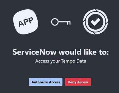

I get the authorize access popup

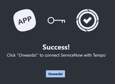

Success:

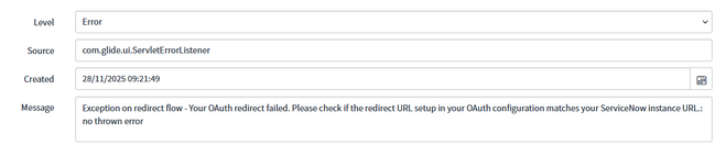

When I click on 'onwards' the redirect kicks in which goes to our dev instance and I get the error:
Your OAuth redirect failed. Please check if the redirect URL setup in your OAuth configuration matches your ServiceNow instance URL.
URL:
https://instance.service-now.com/oauth_redirect.do?code=bcSZI8Q6XHlp2xDw65
(instance name has been replaced)
I am able to retrieve the authorization code in the URL, which I then need to exchange with the API for an access token—but this is where I can’t seem to make any further progress.
System Logs:
Browser Network Logs:
The redirect url matches and has been checked many times so I'm not sure where I'm going wrong.

Hi, @Ashley .
Please review the whitelist or other relevant settings on the Jira side. If Jira requires additional information for authorization, create and customize a dedicated OAuth API Script before attempting authentication.
