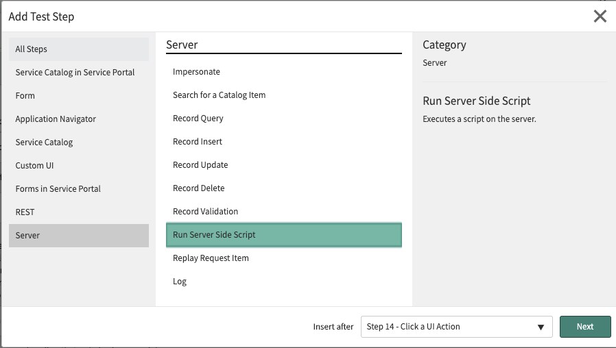

Tim Deniston
When adding a test step, select 'Server' on the left and then 'Run Server Side Script' on the right.
