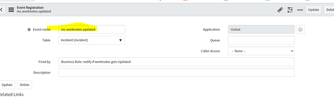

Step 1: Create One entry in Event Registry - "inc.worknotes.updated"

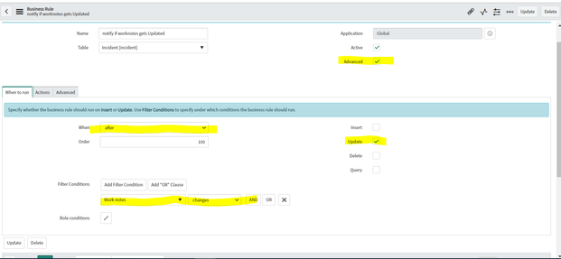

Step 2 : Create One Business Rule on Incident Table
Advanced : True
When to run :
After update
condition : worknotes changes

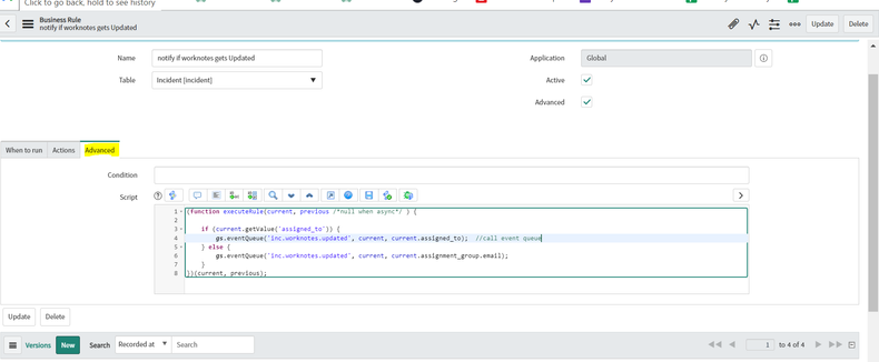

In Advance tab write below Code:
if (current.getValue('assigned_to')) {
gs.eventQueue('inc.worknotes.updated', current, current.assigned_to); //call event queue and send param 1
} else {
gs.eventQueue('inc.worknotes.updated', current, current.assignment_group.email);
})(current, previous);

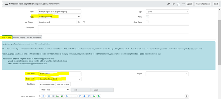

Step 3 : Create a notification on incident table
When to Send Tab :
Send when : Event is fired
Event Name : inc.worknotes.updated

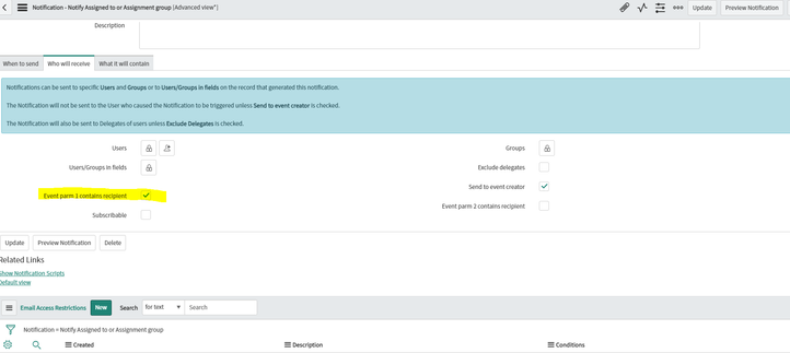

In Who will receive Tab
Make sure to check Event parm 1 contains recipient field as in business rule we are sending the param 1
