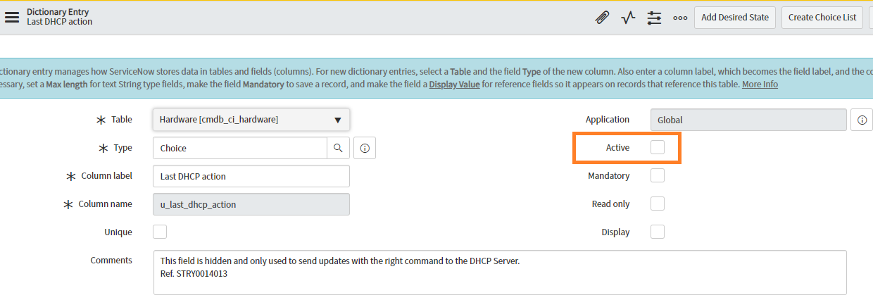

Of course we tried it already out on a Developer Program instance where we set the field "task.active" to false and checked what happens...
Nothing... (at least not noticeably now)
It seems just to become unavailable on UI level, however if you use it on script level everything still works fine. No errors, no warning, nothing... it works
You can even pass it as URL parameter and it works
It's just not available anymore on any UI element such as the list personalizing or drop-downs
Of course this is logical from a database perspective, because you cannot disable a field in a database.
The field is only disabled on UI level and it seems that framework level is NOT impacted.

I have a similar issue whereby we have some legacy scrum fields that need to be removed from forms and one of the criteria is that "the fields should no longer be selectable in reports".
If I amend the read ACLs for these fields (as we would normally do) then the fields are still selectable in reports but will be empty (no read access).
Obviously the above method would be a lot better (and easier) but I'm not aware of any implications in doing this.
