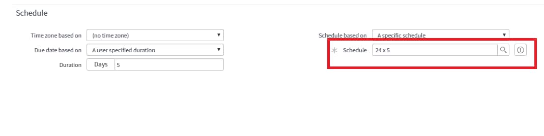

We can write script to set the task due date dynamically as like below. but i would like to how to set the schedule to 24X5 using this approach..

I refer this part of the schedule in the   catalog tasks. Usually we wil set 24X5 when we do it through catalog task activity.. When it comes to script, how we can do it?

I dont have a schedule defined... what i would like to do exactly is, i want to calculate the due date based on "24X5" schedule and the number of days..
Say for example the number of days defined for completing a task is 5.. i want to calculate due date based on the SLA of 5 days for the schedule "24X5"
