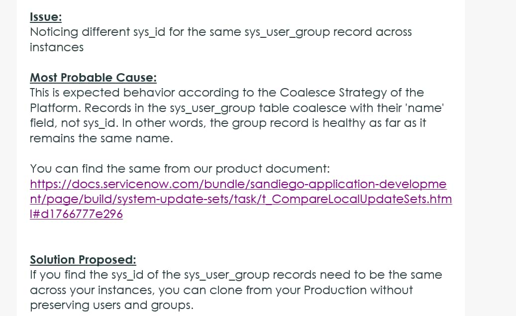

Should the sys id of groups match across all instances (dev,prod,test)?
For some reason, we got a group that does not have matching sys ids across the instances,
I send the issue to ServiceNow and they said that this was OK?...... which seem really odd
Then we have big time Chuck, AKA ServiceNow OG AKA ServiceNow GOAT with the following post::
Chucks post answer:: https://community.servicenow.com/community?id=community_question&sys_id=7b4f4fe1dbdcdbc01dcaf3231f961981
servicenow post:: Compare local update sets (servicenow.com)

For OOB groups, they are usually the same but even if they are different, what SN noted in your original post is true.
For instance, if you promote an SLA record referencing a group in its condition from instance 1 to instance 2 where the underlying sys ids of the group record are different across the two instances, the system will still recognize the group in instance 2 via group name and match it.
