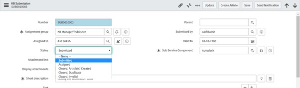

I have a UI Action form button "Send Notification", which has to be shown only when a certain value is chosen from the status choice list.
I have provided the condition but it is working only when the form is loading. is there a way to make this happen without saving the form and reloading it.
The UI Action i configured.
Also a clarification, does the UI action form button gets executed only during a form load?
