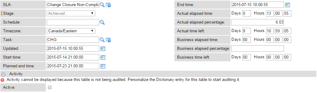

We have an SLA for the Change request table.
I am checking the Task SLA table where we have two task sla records created at same time. The acheived SLA is the correct one.
I have 2 questions here:
  1. Why was there a second SLA attached? Is it because of the start condition?
  2. Why didn't the second SLa stop like the first one?
The value of end date for the change was 2015-07-14 21:00:00
SLA definition:
Task SLA:
Edit: The SLA's did not get created at the same time. I was previously referring to the 'Start time'.

Hi Srinivas, Check the attached image, both SLA's were attached at the same time.

I was referring to the 'Start time'. I just checked the created on date of the SLA's and those two were different. The SLA seems to have got attached when the user tried to cancel the ticket. I am checking the history of the ticket, the updates were broken into 2 updates on the same time as against just 1 update. First update modified other fields and the second update change the phase to close. I guess that is the reason why this SLA got triggered. Not sure why there were 2 simultaneous updates..
