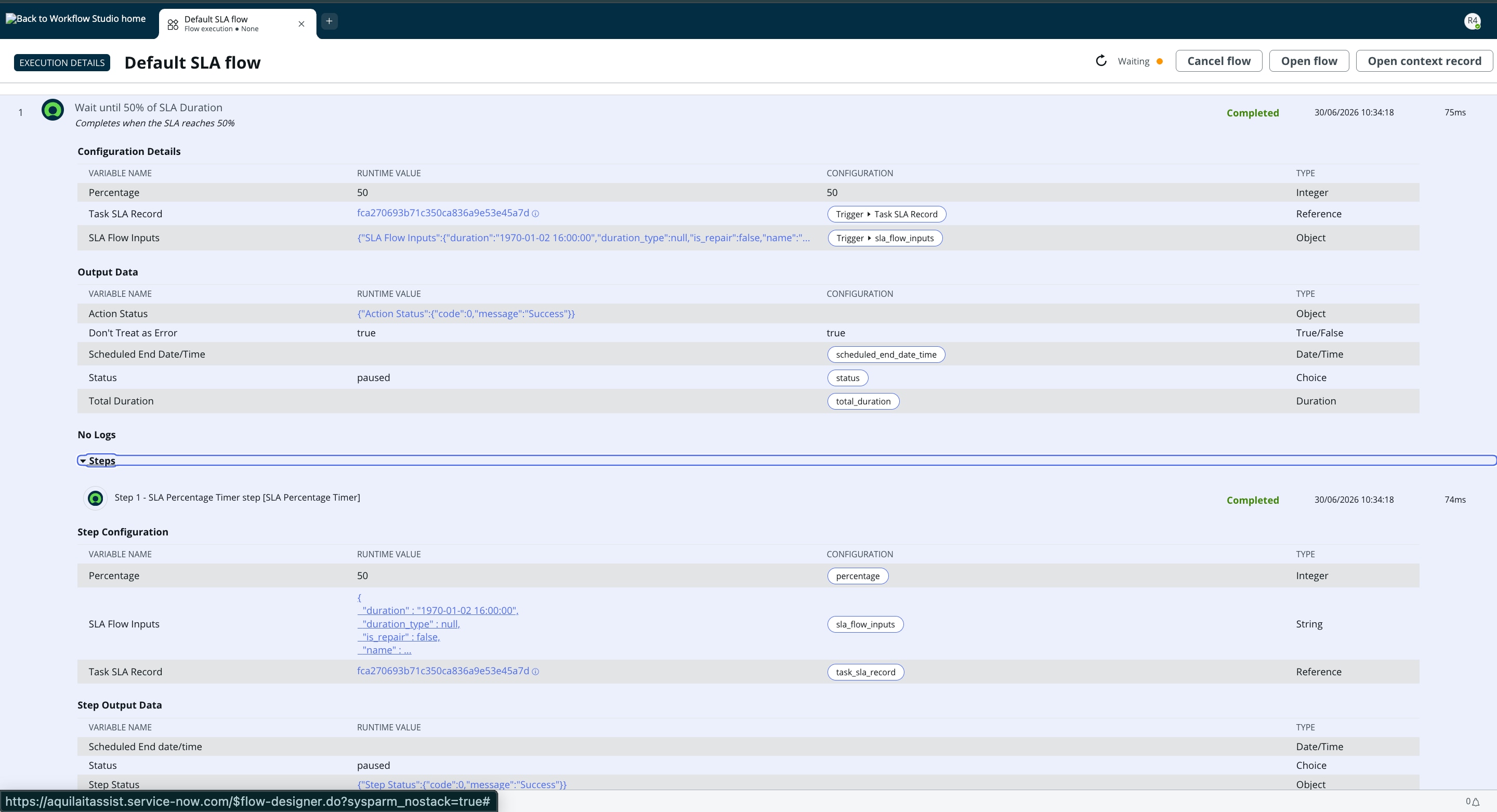

I have used the "Wait until X% of SLA Duration" to trigger SLA notifications.
Issue: My task_sla is in Paused state but the flow just continues to go to next step and marks it up as completed.
it cross 50% mark then 75% mark and doing the subsequent action.
SLA Percentage Timer step [SLA Percentage Timer] is not behaving correctly. Is anybody else observing the same issue & please suggest some workarounds.
