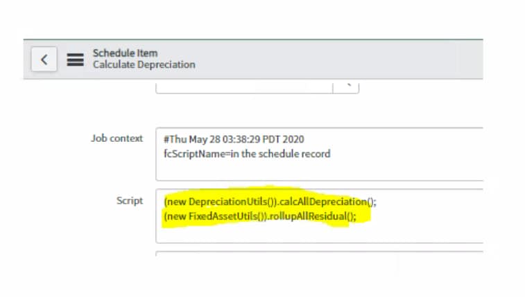

Each of above will have an entry in sys_trigger (Scheduled Job) table i.e. from Application Navigator
System Scheduler >> Scheduled Jobs>> Scheduled Jobs.
You can search with name & get the record. You need to open & then look for the script field which will have possible script include & function being called.
For eg. Calculate Deprecation has below.
These are system specific OOB scheduled job that are in place for some or other action in backend & may/may not execute everyday.
Look for each one you highlighted & get an understanding of what is that job meant for.
