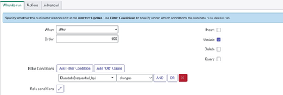

I've created a BR in order to update a value from demand tablo to an enhancement table. It's a simple query and no much more...
but for some reason it runs very slow
the business rule is an 'after' type with a particular field change and it should modify a field in another table with the same value so:

I tested this BR in PDI and it works fast.
I used the field 'enhancement' because it is the reference field from demand table to enhancement table and because I couldn't find a reference demand field from the enhancement table.
