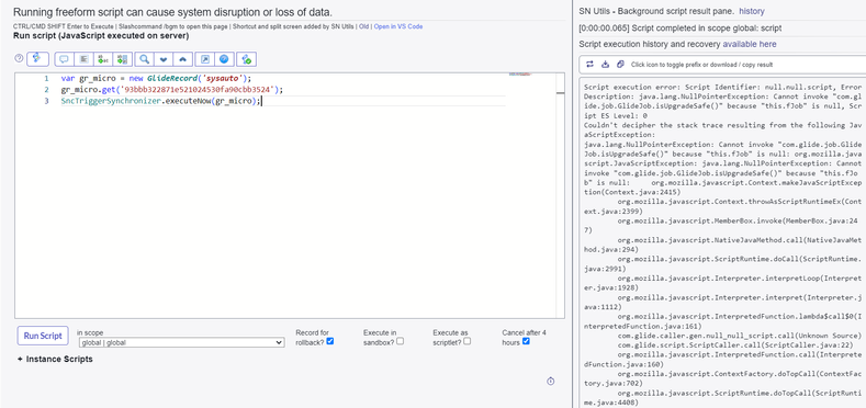

I am trying to launch scheduled job from Background Script and it does not work. The script I am using is
var gr_micro = new GlideRecord('sysauto');
gr_micro.get('93bbb322871e521024530fa90cbb3524');
SncTriggerSynchronizer.executeNow(gr_micro);
The error that I am getting is shown in the following image:
Can anybody help me? I have checked that the sys_id is correct, so the record is correctly found.
Ravi Gaurav
Hi @jordimsant
Ensure you are logged in as a user with the admin role and that the instance allows background script execution of such operations.

Thank you for your help! The problem was the "Run as" field, I suppose that the previous user has not the rights to execute the script
Shruti
var gr_micro = new GlideRecord('sysauto_script');
