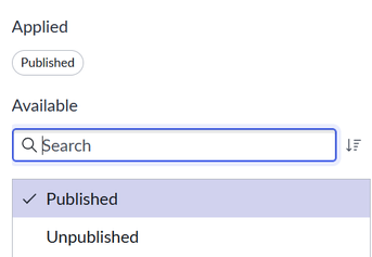

In all SAM workspace reports you will see that reports are now based on your specific scope of products , “Published status” filter is now visible :
You can filter the reports on “Published” or “Unpublished” products :
