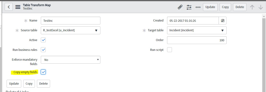

Hi
In your transform map have you checked "Copy Empty Fields"? Keeping this field as true will copy empty source fields and override existing target field values.

Hi Rajesh,
Thanks for the suggestion, However I have already tried this and checking "Copy Empty Fields" checkbox is clearing out other fields as well which I don't want.
I want to clear only my custom made choice field(u_team) to get reset to --NONE-- when i send ""(single space).Also if there is any other way to reset the choice field if someone passes single space then please do let me know.
