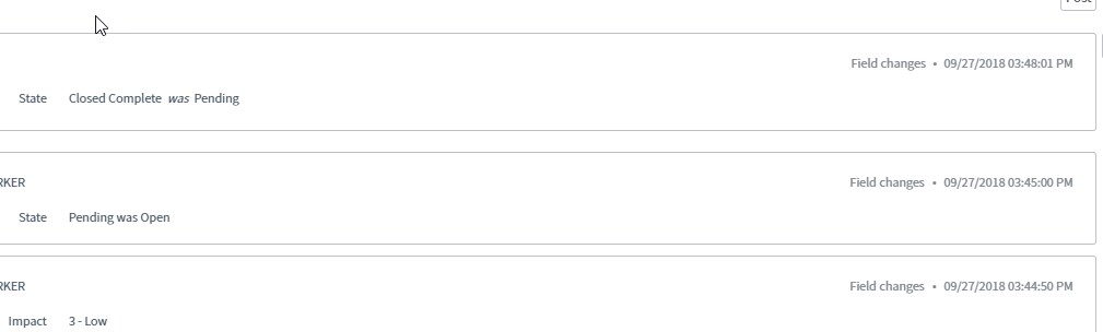

As you pointed out, "Pending" is an out-of-the-box choice, while "Closed Rejected" is not. If you add a custom value of "Closed Rejected" to your choice list, can you still set it to that value?

09-27-2018 01:03 PM
You have something overriding your changes or something else happening since it's just skipping your setting of the state value. The custom "Closed Rejected" state worked fine in my instance with just a 1 minute wait this time:
