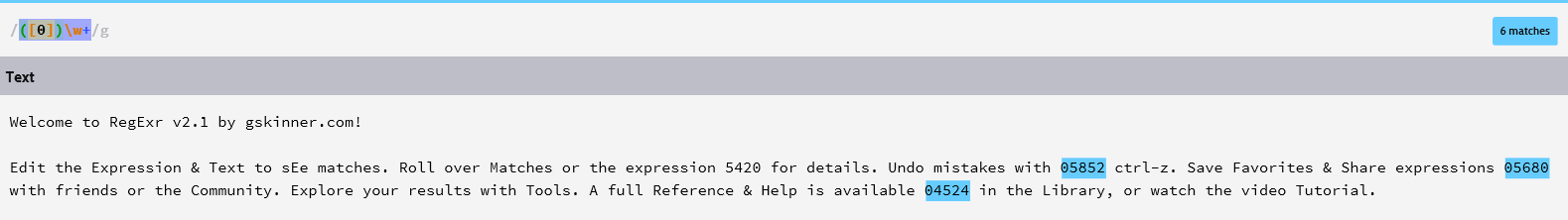

The problem with these is this email comes directly from HR. Which means nothing is consistent. I've seen it come through as ""Whse: 04901 Flooring", "Whse 04901 Flooring", "Whse Flooring 04901", etc. The only thing I can rely on is that somewhere in that string there will be a 5 digit department number starting with '0'. It may or may not be after something like a colon, may or may not be the 2nd word in the string. So I really need something that read the string, finds the '0' and gives me that number and the four after it.
I have never used RegEx and I don't know anyone else who does. So, I have a small question on it. I did some testing and when I added some example department numbers in the text and then changed the top to "/([0])\w+/g", it seemed to comb through and highlight properly:
So I tried it in my inbound script like this:
var dept = email.body.department.match(/([0])\w+/);
And then went into the request item and now logged in the department variable is this:
org.mozilla.javascript.NativeArray@1e1c7be
Should I be putting the 'g' at the end even if I want it to search the string for just the first one? or should I not have included the '/'s? I feel like this is definitely helpful and in the right direction. I really appreciate the references.
Hi Alex,
  1. In regex, "\w" will match any alphanumeric, "\d" will match a numeric digit only [0-9]... so I would use "\d".\
  2. If you only want the first match, don't use the "g" switch.
  3. Yes, you need the "/"s... that's telling it you are using a regex statement in between them.
If it is always going to be a 5-digit numeric somewhere in there, but the rest is unpredictable, I would use:
                  var dept = email.body.department.match(/(\d{5})/);
You don't need the "i" switch anymore, since numbers have no case.
