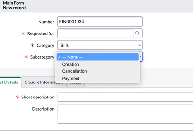

It works clearly in the default viewšŸ‘‡

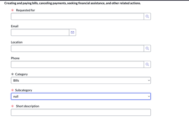

but not in the record produceršŸ‘‡ In record producer, the subcategories are shown in the dropdown as null, and the categories are displayed exactly right.
What is the reason?

Thanks for your advice.
I have adjusted my queries to the information in this article and it turned as a solution.
