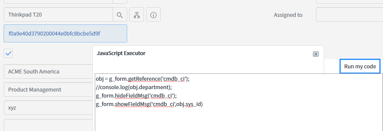

Is it possible to invoked methods on g_form in the console of chrome? I tried and it did not find the object. Wondering if there is any wrapper or  in anyway. Appreciate it.

Thanks Brain. I tried alert and it did not work. I am sure it worked one time in console I can type g_form. I think it worked in Chrome console otherwise in Firefox.
But I am able to use this by invoking SNOW Javacript executor using Ctrl+shift+alt+j, though it is pain to type.
