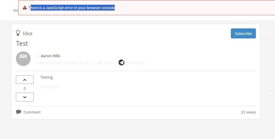

The customer is not able to comment on Idea portal. After impersonating that user.
Rai Shivam Ajay
The customer is not able to comment on Idea portal. After impersonating that user. Please, Can any help me. As below I am attaching the screenshot. Error getting is There is a JavaScript error in your browser console

Hello Prashanth,
I have tried above step as you mention , Still I am not able to resolve my issue, As below I am attaching the screen shot of console.
I am getting error in fetchComments and getCommentId.
As  below I am pasting the code , please can you review it.
