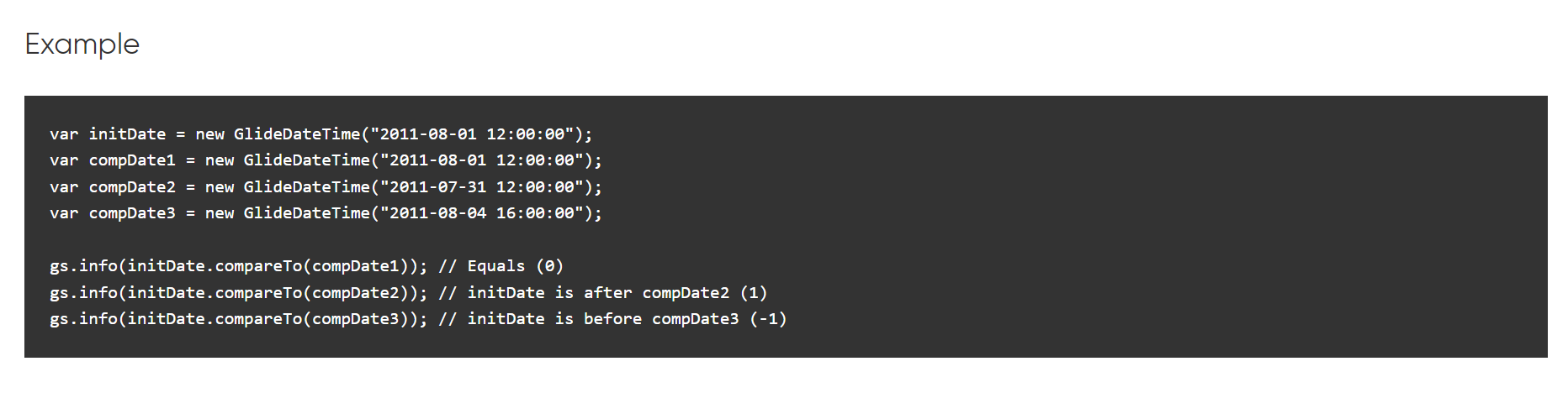

Did you try using the "compareTo()" function to compare dates.
You can refer to this API:
and try to use this function:
For your logic you can use this like:
var currentTime = new GlideDateTime() // Get Current Local Time
var begTime = new GlideDateTime("2020-08-01 12:00:00"); //Pass your begin time
var endTime = new GlideDateTime("2023-08-01 12:00:00"); //Pass your end time
var begTimeComparison = currentTime.compareTo(begTime);
var endTimeComparison = currentTime.compareTo(endTime);
if (begTimeComparison == 1 && endTimeComparison == -1) {
gs.info("Success");
If that doesn't work, try using getNumericValue() and then compare them the way you are comparing.
Thanks.

So, if for time fields we are getting it from 1970-01-01, can we try something like this?
var getCurrentTime = new GlideDateTime().getLocalTime().getDisplayValueInternal(); // Get Current Local Time
var currentTime = new GlideDateTime("1970-01-01 " + getCurrentTime);
var begTime = new GlideDateTime("1970-01-01 12:54:27");
var endTime = new GlideDateTime("1970-01-01 15:54:27");
gs.info("Success");
