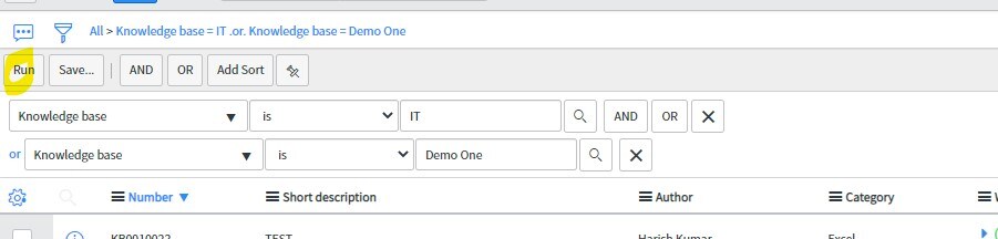

In that case you can use encodedQuery.
var query = 'kb_knowledge_base=a7e8a78bff0221009b20ffffffffff17^ORkb_knowledge_base=862c887e07d20110f1cbf48f7c1ed0c5';
var nowDate = new GlideDate().getDisplayValue();
var gr = new GlideRecord('kb_knowledge');
gr.addEncodedQuery(query); //you can add knowledge base sysid here
gr.addQuery('valid_to', '<', nowDate);
gr.query();
while(gr.next()){
gr.setValue('active', false);
gr.update();
Refer screenshot to run query
