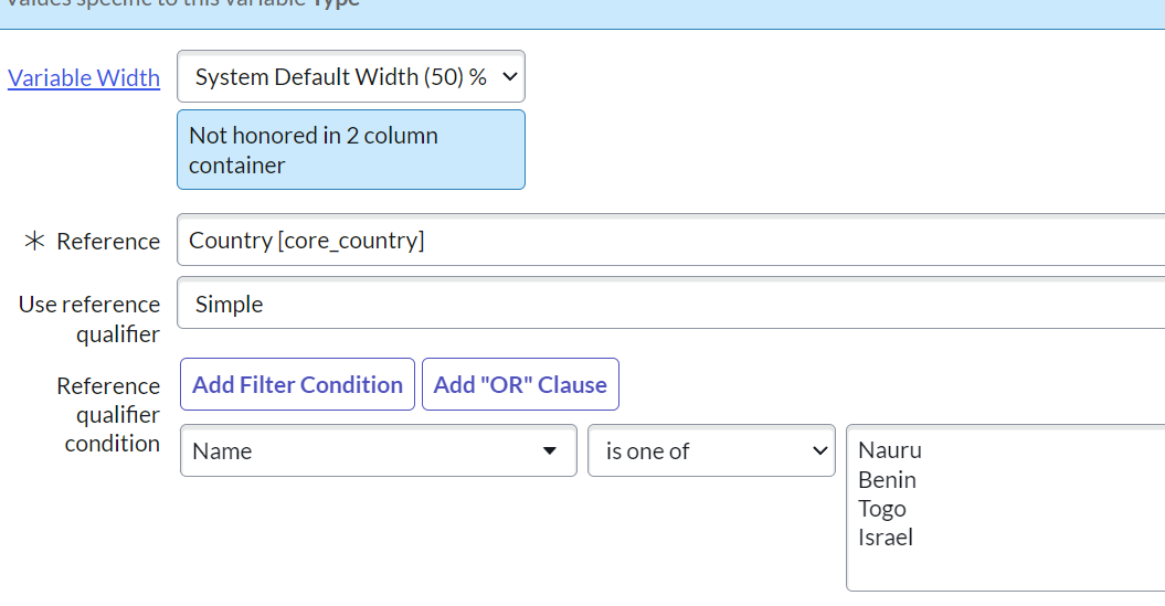

To hide a choice from the reference filed for a particular option in the select box field
when the type select box field has the option as B . I do not want the option "Nauru" to be displayed in the reference field place.

I did not understand . Could you please explain

I have some exiting condition in the reference qualifier
